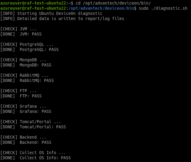

What You Will See During Execution​
  • Each check item displays: [CHECK] start, [DONE] result.
  • If some passwords cannot be retrieved automatically, the script prompts clearly for input (for example: PostgreSQL, MongoDB, RabbitMQ, FTP).
  • Characters are not echoed while entering passwords.
