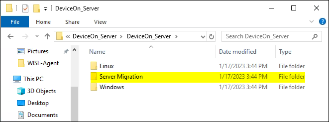

  • Step 1: Download the latest version of server installer
  • Step 2: Extract the zip file, there is a tool/folder called "Server Migration".
    Server Migration Tool Location
  • Step 3: Copy the tool to your production server and start to backup data first.
    Refer to Server Migration
