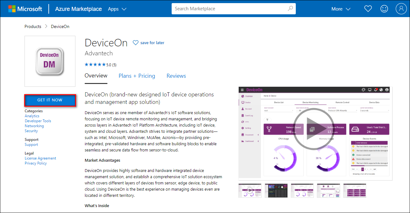

Azure Marketplace
Step 1: Deploy DeviceOn from Azure Marketplace​
Please enter to Azure Marketplace and click "GET IT NOW"
Azure Marketplace Get It Now
